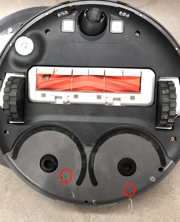

Dreame Support NL 4 Verdieping
Hello, after cleaning the mop pad, remove the mop pad from the mop pad holder. Attach only the mop pad holder to the robot. Start a mopping task from the base station. Wait five minutes and check for water droplets on the floor.
If no water comes out after the above test, the robot may not be able to dispense water while mopping.
Please remove the mop pad holder and poke the water outlet on the bottom of the robot with a wire, toothpick, or other object (see the attached image). Check again to see if the robot can mop normally.
